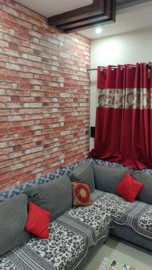

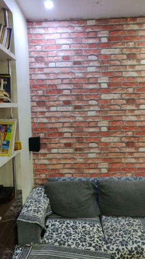

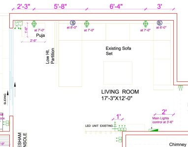

Below is the placement of my living room. Can you recommend the placement of 5.1 speakers here. The wiring will be done through the ceiling.
I am giving the provision of mounting one of the speaker either at puja room partition or balcony wall 4 feet above ground. Have told electrician the same.
Also, I have not thought about the Atmos speakers yet, but want to provide the provision for the same. If I feel, will go for the same after 3-4 years, by cutting the POP at Atmos speaker placement. Where do we make the provision for conduits and speaker?

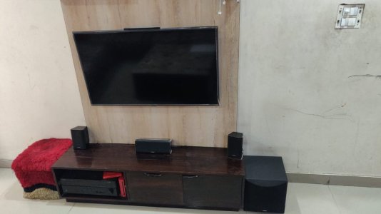

The current setup at old flat is also attached herewith. The new setup would also be done this way. Is it ok?
Old flat living room setup
