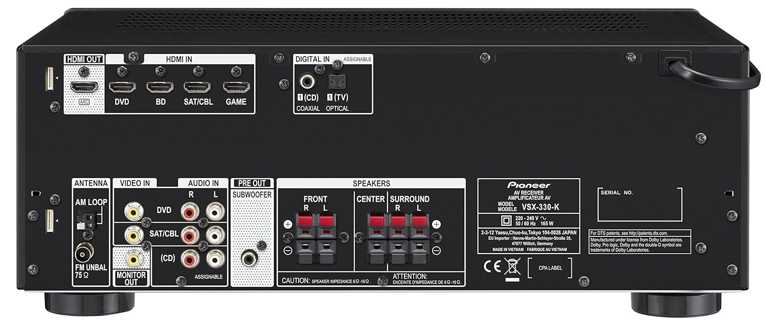

Looking at the rear images of the Pioneer VSX 330 AVR, it is mentioned as speaker impedance as " 6 - 16 Ohms".. So there is a probability it may/may not work with your 5 pieces of JB speakers.. My guess is, it should work..
So consider other 5.1 entry level models from other brands that offer 4 Ohm support as alternatives..
Thanks bro. Can you suggest one?
Looks like most entry level AVR support from 6 Ohms - 16 Ohms.. So not much choices there..
But if you are fine to consider used AVR, for the same budget as a new 5.1 AVR, chances are that you can get a good one that can handle 4 Ohms too..
