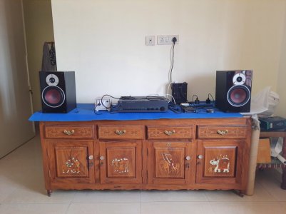

This is my setup. As is evident this is a 6 ft long table with 2ft depth.
The table has a wooden top and to protect the inlay work on topside a 5 mm glass covers the top completely.

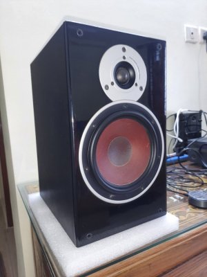

Earlier I put 1 inch foam sheet under the speakers to isolate. Now after placing an yoga mat to cover the entire glass top, the sound has improved dramatically.
What would you all advise for the material of yoga mat to procure? EVA,TPE and NBR yoga mats are available on Amazon.
Any others suggestions are welcome.
Thanks in advance.
Pull the whole cabinet (with the speakers and all) little by little out into the room till you find the best sounding position.
Speaker isolation can be done in many ways. One of the method that I have seen in a video is putting thin sheet of cork below speakers (same size as speaker bottom), others can be rubber feet (4 per speaker) these are available for very reasonable price at doogesound website. I also use speaker isolation to isolate speakers on the speaker stands but that isolation had come along with speakers, small silicon material pods that are flat on one side and round on the other and the flat side has sticking tape to stick to the speaker bottom. Putting yoga mat or anything made of rubber below the amplifier is not a good idea as the model of NAD integrated amp in the pic the heat sinks are placed in way that it generates lot of heat both on top & below the amplifier. I have used similar model for almost 15 years and I can say the heat generation is very high. So take care of that and save your equipment.
Note - In case u want to check cork sheets then it is available at Mr. D.I.Y store in round table placemat shape. That also can be used below speakers.

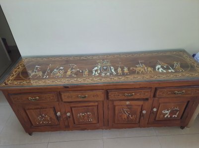

Thank you all for your assistance. To give a clearer idea,the table is like this without any equipment. Please notice 5mm glass from end to end on top.

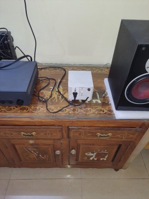

Overall the stereo imaging is good. My problem is that the reflections off the exposed portion of glass all around the speakers seem to diminish the overall sound quality.
Kindly observe the following images.
Am certain there are many unwanted reflections off the exposed glass.

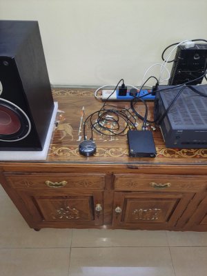

Am actually happy with the imaging. The bass is tight. When multiple instruments are present say rock music, that's when I feel some improvement is needed. This I feel is because of glass. When I used the yoga mat clarity when multiple instruments are present was observed.

Thanks a lot for your observation regarding the NAD amplifier. It usually is warm but after my yoga mat experiment it was very warm last evening. Shall place nothing beneath the amplifier.

Kindly advise/correct me as to how effectively I can reduce the sound reflections off the glass top.
Beautiful wood unit with such nice hand Kraft work. Looks like it is made of sheesham wood. Now about the glass which I think is a necessity to protect the top platform. Try to make a platform of some good wood little elevated from the glass and place it below the amp. If you are aware of a brand called "sound foundation" mumbai based which is mentioned a lot of times in this forum they do not make any audio storage unit with glass, they only use wood or acrylic sheet and there must be some very good reasons for it.
In reality glass below anything like amp, other audio equipment or speakers is not a very good idea. You have to experiment and see as it seems glass on the top is the only option you have. Try experimenting without the glass for a day or two and if results are favourable then discard the glass. Finally it is audio satisfaction that is more important then the aesthetics.
