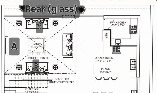

This is my first thread for more than two years. My home is under construction and I am going to have a dedicated audio room (14' x 22') in the basement, But I am not going to have a dedicated room for HT. So I want to use my living room as a home theatre where we all will be spending most of the time in the evening and then go to our respective bedrooms in the late evening. Gradually I'll also install a UST projector and 120-150" screen along with AVR, multichannel amp and as many speakers as I can fit.
Our living room as shown as a Lobby in the layout plan is 16' x 20.10' and is double height. surrounding area like kitchen etc are of usual hight. Now our architect wants to have a TV and screen at A but I don't like it there. I have always wanted a living room with TV/screen on the longer wall as it looks better that way. Also, it will be a bit awkward for us and our maids working in the kitchen while watching movies/series rated A or something like that. I hope you get my point.:)
So that's why I would prefer the area marked as B. When I told our architect about area B he suggested area C which I hate as we will be looking at Tv and huge rear glass at the same time. Also I can not have a huge LCR just a few inches away from a huge glass wall. At point B, the area under the stairs can be used to place the AV gears.
So my questions are.
1. Do you guys agree with me about the area marked as B?
2. If yes, where and how do I install in-ceiling and rear speakers? ( Remember living room is a double-height)
Welcome back @rsjaurr :)
If it was me, I would go with "A" as the architect suggested. In this configuration the room would be symmetric for the audio chain. And will enable placement of surround rear channels optimally as well. The audio gear can still go under the stairs in a dedicated cabinet, with all wiring pre-done in the flooring or through the walls for an uncluttered look.
The only issue will be getting effective atmos effects, given the double height ceiling. Will need atleast 4 in ceiling speakers of minimum 10 inch diameter i think. With a dedicated UST screen mounted at position "A" any light coming in through the huge glass wall should'nt be an issue. Though it might be bothersome for a normal big screen TV.
