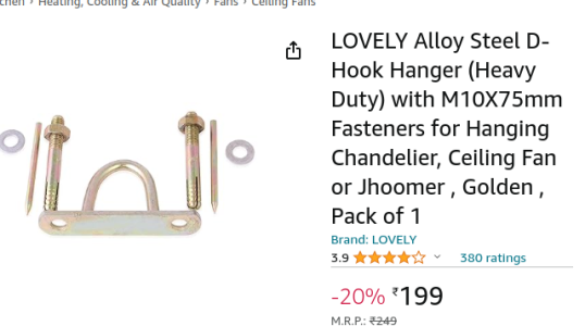

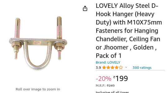

It is not difficult to mount a celing fan. You have to get this D holder. It is available in any hardware shop. First two holes have to be drilled to insert the two rods. Need to use 10 mm diameter drill bit for drilling holes on ceiling or wall to fix Fastener. The drilling depth should be greater than or equal to 65 mm. After that the pins have to be pushed inside with the hammer. When you hammer the pins, the rods expand making the D hook get a firm grip in the concrete. Pull out load is 75 Kgs and Jerk/Vibration load is 40 Kgs. I did this myself at 4 places in my current house. All of us are still alive and kicking as of now. What is important is the drill bit has to be 10mm.
Yes this is the same way wherever the hook is not provided in the ceiling it has to be done and i have done for my house in this fashion for the chandelier too. But still requires a support from proper person who can drill to the exact depth needed and and tight it as required.
If you have proper DIY skills to do can do or else it will not come as intended..
Tread with caution... we had used similar hook/screw for fitting a swing in the balcony. In the first two- three days the swing (single seater and made of cane) came down with just my daughter's weight (she was 7 yrs old at the time). The mason & carpenter apologised saying they will try better next time :) If a rotating fan comes down on the driver, a simple apology may not be enough................ Have some kind of reinforcement also if possible to affix it.
Exactly , in my house the plank swing was fitted in different single hook style with similar thread and slowly it started coming down. We removed the swing before it could come off fully.
The ability of concrete fasteners to hold long term is very dependent on the quality of the concrete used for casting the roof.
Unless one has personally supervised construction the risk of poor concrete and consequences of falling down are just too great.
While concrete quality is also a factor, the hole drilled into the concrete should be wide enough (as specified by hook manufacturer) so that the hook rod can expand into the concrete and hold tight. I think this is where most of the issues arise.
