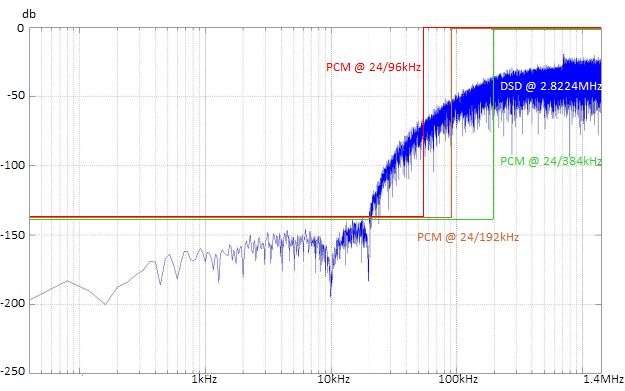

The theoretical frequency bandwidth of a DSD signal with a sample rate of 2.8224MHz (64 x 44.1kHz) is 1.4112MHz. Compare this to a 96kHz PCM signal which has a theoretical bandwidth of 48kHz, or 192kHz PCM signal with a bandwidth of 96kHz. However, this wide bandwidth comes at a price: pure Delta-Sigma signals are quantized to 1 bit and, therefore, do not have a great dynamic range by themselves. That is why Delta-Sigma converters need to incorporate a process called noise shaping that increases the dynamic range in the usable audio range (0-20kHz) and then slowly decreases it over higher frequencies. It is this noise-shaped delta sigma signal that is then called DSD. Fig.2 below shows the typical dynamic range of a DSD signal sampled at 2.8224MHz which can be greater than 150db in the audio band below 20kHz. The slowly rising noise floor at higher frequencies also follows to some degree our hearing threshold for transient signals that have been proven to be audible up to 100kHz.
Of course, DSD at double the rate (5.6448MHz) has an extended audio range of 0-40kHz above where the noise floor then starts to rise gently.
Fig.2 also shows the theoretical dynamic ranges of high resolution PCM signals at various sample rates. Note the steep brickwalls that PCM signals typically have. It is those brickwalls that can generate very audible side-effects such as pre-ringing, if not processed with special algorithms (such as in all Playback Designs products). By design DSD signals do not generate these side effects.
Fig. 2​
As we can see from this, DSD is characterized by the following:
  • great dynamic range in the audio band (0-20kHz)
  • slowly rising noise floor in higher frequencies (no brickwalls)
  • extended frequency range into MHz
This makes DSD a serious contender in the choices of high resolution audio formats. Sometimes DSD is criticized for its high frequency content (as shown in Fig.2). But all DACs limit the amount of noise that actually gets through to the analog side. This noise is generally not correlated to the music signal and therefore is easy for our psychoacoustic hearing system to filter out, but most listeners do not even hear it. Double rate DSD addresses this problem by pushing the ramp of the rising noise floor up on the frequency axis by about 20kHz thus reducing the absolute noise floor in the higher frequencies quite dramatically.

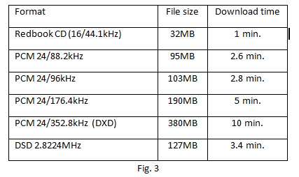

Internet Download Bottleneck
Clearly, packaged media is slowly on its way out. It has limited the evolution of audio formats for too long. As the computer platform does not favor one particular format over another, it is becoming an artistic decision for the recording engineer and producer which format to use for which application and market. With fewer and fewer disc pressing plants in the world the era of high resolution downloads to computer has already started. When combined with an external DAC and configured for high quality playback the computer can be a formidable audio platform.
The various high resolution formats that are currently in use can have very different bit rates, which impacts the time it takes to download the files from the internet. Fig. 3 lists different formats along with their files sizes for a 3 minute song and download times assuming a 5Mb/sec internet connection.
As the sample rate is increased beyond 96kHz PCM formats create relatively large files that take quite long to download. The file size and download time for DSD on the other side are comparable to 24/96kHz PCM, yet offer greater performance as we saw in Fig.2. Often the DXD format is compared to DSD in terms of sonic quality, but as we see from this table DSD is about 3 times more bit efficient. This comes from the fact that DSD doesnt have a flat frequency response as seen in Fig.2, but rather adjusts resolution in very high frequencies where our hearing only has very limited resolution as well. For this reason and the fact that a large library of DSD recordings already exists, DSD may become the dominant format for high resolution downloads.
