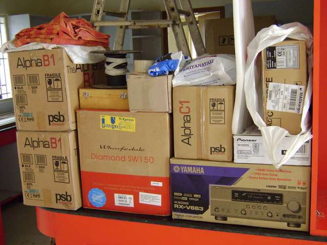

In the meantime, I did a bit of auditioning and finalized the equipment that needed to be purchased. The list is as follows:
I actually wanted to pick up the Canton sub from their Movie 60 series, but unfortunately I could not get a piece as a complete import consignment was stuck with customs. I also wanted to consider the Q-Acoustics sub, but could never audition one in time. So it was the Wharfedale.

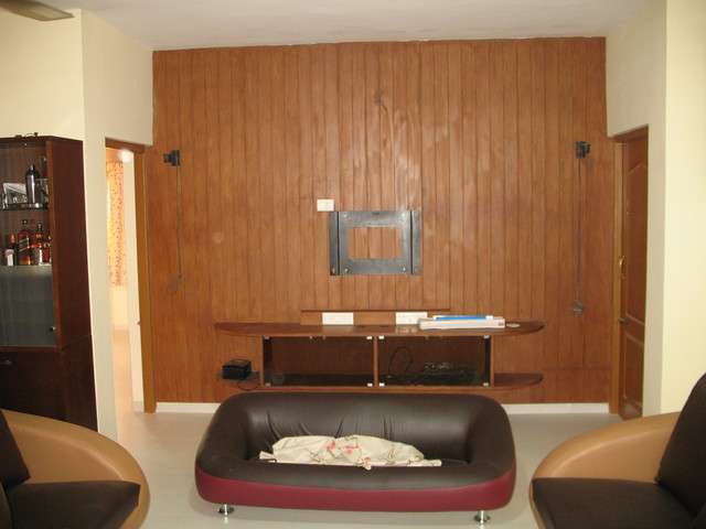

This is a view of the wall where the TV is to be mounted. On the left you will find a bar. The rest of the left wall has been covered completely with thick drapes. On the right, though not visible, is a staircase. The entrance to the room from the staircase has been blocked with a double glazed all glass wall and door. The small black marks you see on the top of the wooden wall are the base clamps for a TV wall stand that I used for mounting the speakers. I show a closer picture below.

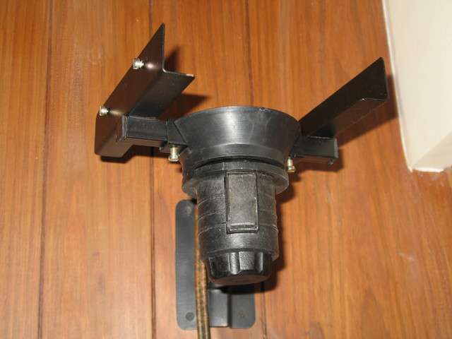

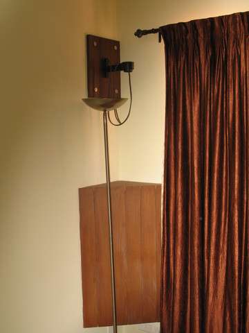

Instead of mounting the surround speakers on the side of the sitting position, Shyam had taken the liberty of instructing me to mount them to the rear walls. Though I was unhappy with this, I had no option.
What he had done, though, was mount small wooden boards to cover the walls directly behind where I was mounting the speakers. The room has only one corner, and I had asked Shyam to build a simple triangular bass trap that is shown in the above snap.

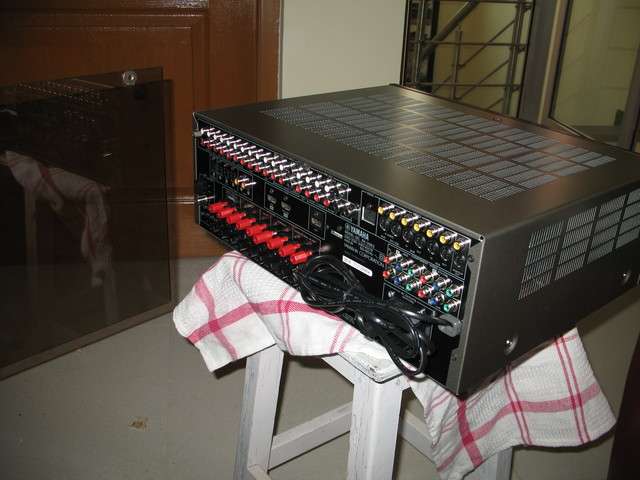

I then opened the Alpha B1s and mounted them on the stands. I then unpacked the 663 and kept it atop a stool to make all the connections at the back.

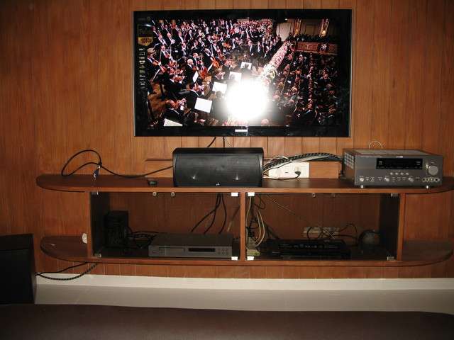

Using some help, I got the monstrous TV mounted on its wall stand just above the system rack.

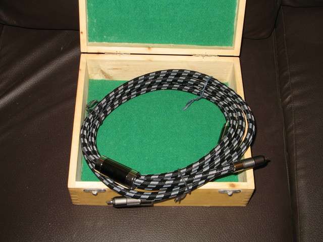

I then placed the sub on the floor to the left of the system rack. Using DACs most expensive subwoofer cable I connected the sub to the AVR.

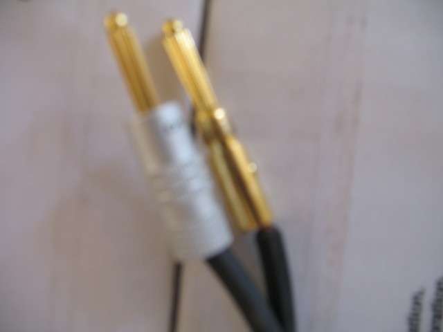

For each speaker, I used gold plated banana plugs from MX. I carefully stripped half an inch (1/2) of the shielding from the cable ends and inserted them into the banana plugs. In the photograph below I show one cable inserted into the banana plug, and the other completed with its outer cover.
The DAC speaker cables have one cable of the pair marked with specifications and company name in white across the whole length every 12 inches or so. I used this as the +ve cable and the other as the ve. This worked perfectly for me to ensure correct polarity excepting in one cable where the carpenter had painted the whole cable making it impossible for me to see the markings. Fortunately, the Yamaha AVR has a simple test to test the polarity, and it immediately caught the error. For that speaker alone, I switched the cables, and the AVR was happy.
I connected the Pioneer 610 to the AVR using an Atlona HDMI cable, and the AVR to the TV using another Atlona HDMI cable. For a simple test, I inserted a DVD, and the picture was coming on the screen. I had, by now, got the principle parts of the HT working.
To set the TV, I inserted the Avia 2 DVD, and ran into my first hitch of the day. Can anything work without any hitch? After all Murphys law has to work, right? In contrast setting, Avai divides the screen into two parts. The right half is bright white, while the left half is a black screen. On the black screen there are two white bars that keep moving about the screen. The objective is to set the contrast ratio to such a level where the left bar disappears and the right bar will just be visible. The problem was I could not see the bars at all. After some heavy thinking and cursing the Pioneer, Yamaha, and Avia, I decided to connect the DVDP to the TV directly. Presto! The bars appeared magically. So I used this connection to set the TV.
When the TV was set, I reconnected the Pioneer to the AVR and the AVR to the TV. I used Avia again to test the audio was working properly.
I then used opened the mike provided by Yamaha, connected it to the AVR and set the mike atop a lot of contraptions to simulate my ear height while sitting. I used Auto Set Up, and Yamaha asked me to shut up or leave the room. Mumbling to myself, I sneaked to a corner to see what the AVR did. It first tested the presence of all the speakers, then the polarity. Since one of the speakers was connected wrong, it cursed me and stopped the Auto Setup. I then reconnected the speaker cables properly and started Auto Setup again. It now moved happily beyond the polarity. It played pink noise on each speaker starting from the left front and going full circle. With the pink noise it measured the distance and set the speaker levels.
Yamahas YPAO made two mistakes. One; though it recognized the presence of the sub, it set the front speakers as large and the cross over as 80Hz. Using manual set up, I reset the speakers as small and the crossover at 65Hz. Two; it had set the speakers levels at 60dB as measured on the SPL meter I was using. I am more used to 75dB, and I set all speakers at that.
I then used the Avia 2 DVD again to set the sub. Avia plays a note that starts at somewhere around 250Hz, and keeps going down continuously till it reaches some 40Hz or so. It first plays the note on the left front along with the sub. It then plays it across the room for all speakers individually along with the sub each time. The objective is to ensure that the sub takes over smoothly from the other speakers. There should not be any gap when the front, centre, or, surround speaker stops, and the sub takes over. After a bit of experimentation, I set the sub at a crossover of 75Hz, and it worked perfectly. The transition was smooth and I could hear when the sub stepped in without a gap.
Yamaha has one more feature. In addition to setting individual speaker levels, you can also set the AVR to start at a prescribed level called initial volume level. This is the volume at which the AVR will start when you switch it on. I first tried using the dB levels displayed on the AVR. By mistake I set it at -3.0dB, and nearly got my ear drums busted. I then set it to the lowest possible level. And then, using my trusted SPL meter, I increased the initial volume level till it displayed 60dB on my SPL meter. This was more comfortable. On the AVR display it showed -18.5 dB.

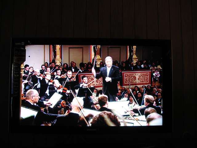

The first DVD I inserted after I was comfortable with the settings was the 2007 Neujahrskonzert, The Viener Philharmonikers New Year Concert conducted by the legendary Zubin Mehta. This is a Deutsche Grammaphon DVD filmed in High Definition with DTS 5.0 surround sound.
I first closed my ears, and focused on the screen. The picture was perfect with vivid colors, and smooth movement when the camera panned. I could even see the tiny mikes hanging from the ceiling, and the sweat pouring from Zubins face. I was happy.
I then played Track 2 Strausss Flattergeister. The sound was very very good, and I was surprised that bookshelves could play a full Orchestra so well. Every time Zubin would look at a set of artist, raise his eyebrows, and move his baton, I could clearly hear the artists begin their part of the number even before the camera panned to them.
