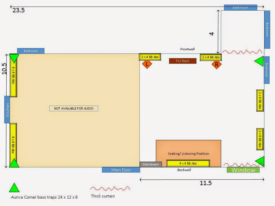

I've been reading a lot on room treatment and found a lot of useful information on hfv. I think I have kind of understood what I need.
I was thinking of going the DIY route but there is that ready to use solution from here
I am not quite ready with a plan but a discount offer on bajao.com for corner bass traps has spurred me into action a little ahead of schedule
The room is 23.5 x 10.5 x 10 H. There a number of doors and one window. There is a small alcove. A portion of the room is not available for audio, but might need treatment ?
The goal is to rid the room of its worst modes and flutter echoes on a budget.
I have made a room plan and shown the treatments I plan and shown it on the figure below. Could you please let me know what you think of the plan.
Should I get the bass traps or will the broad band absorbers suffice ?

Sound cycle,
That is a neat schematic! What kind of problems are you facing?
Is there some kind of partition between your listening area and the non-audio part?
Can you consider moving the setup to another wall/location?
Placing your speakers along the (dotted) division line would be fantastic if you can do it.
What kind of speakers are you using at the moment?
You can limit bass frequencies by closing the bass reflex port of a floor stander with a simple rolled up hand towel.
Very effective and vfm solution.

There is no partition, it is one of those living/ dining type rooms, one long tube. Audio was not in my list of important parameters while searching and buying the house :mad:. No alternate position for audio equipment is possible.
In my assessment the primary problems are flutter echos and that the L speaker is three times as far from the side wall as the R speaker. And then the room modes
I have yet to find out how the new speakers (Dali Zensor 5) fare in the room. I do expect a bit of boom. Should know by Saturday when they are delivered
It make perfect sense to DIY acoustic panels.
DIY it has to be.
I read on hfv that the aurica bass traps I linked to were not effective below 150 Hz and let that pass.
For the rest of it, in addition to a very compelling case for DIY - custom shapes, containing costs etc the cost of shipping the finished panels is very high (about 20%). The next step to my audio project has to be finding a source for rigid fiberglass/ Rockwool in Hyd.

It is easy to get lost in to room treatment maze without knowing what you are doing. That is - you try things without knowing if that's what you need.
Strictly my personal opinion: you don't need room treatment. You need room correction. Get a room correction device you will be happy you didn't waste money on experiments.
However, if you want to stick to this methodology, I'd suggest, before indulging in room treatment rotate your setup by 90 degree clockwise. Place your speakers one and half feet away from all walls. Then put wide-band absorbers on FRPs on either side. IMO, that's best approach in the given room.

Sir,
Seeing the topography of the room, IMHO bass traps as proposed to be deployed by you may not really be effective. For starters, the corners to the extreme left of the pic, i.e. to the far side of the area not available for audio seem too far away to mar the bass frequencies. Moreover I presume that area will constitute the general seating area, so shall contain sofas and the like, which will automatically absorb unrequired reflections. The area on the far right is not really a corner so it is unlikely to create bass loading that a corner typically does. You do have one corner to the right and rear of the listening position, but I would try placing a large plant first.
All the Best!
Moreover I presume that area will constitute the general seating area, <snip>The area on the far right is not really a corner so it is unlikely to create bass loading that a corner typically does. <snip>but I would try placing a large plant first.
I should have put in a pic or another from my sonodyne thread which show the beams and resulting corners which my diagram does not.
I was thinking of plants, bookshelves, and the like as diffusers initially but my net research suggests that they are as (not very ?) effective.

I have a similar setup and faced a similar dilemma not too long ago. What I am currently experimenting with is positioning the speakers along the imaginary partition in your layout - one near the 'L' speaker and the other near the switchboard, about 2.5 feet away from the side walls and firing down the room towards your bedroom. I am not sure how your furniture is setup, but you might want to consider this setup.
I has worked for me in some measures. The soundstage has deepened and the bass has come to its own. While the lows could do with some help from the back wall, what I get now is very natural.
Brilliant ! I guess you end up in a room mode killing position. V intrigued I have to see how this works in my room.

Thanks, the links give a clearer picture.
Since, in the current position the speakers are extremely close to the front wall and there is also no space between the listening position and the rear wall, sound is bound to be compromised.
Could you consider Diagonal placement? You could keep the rack (and the TV) in the corner and have the speakers flanking them. Your listening seat would then be on the opposite wall where the TV and the left speaker currently are. This does appear somewhat radical, but diagonal placements work very well in many cases. You could try this placement to see if there is any significant improvement.

In the completely unnecessary ION dept, suggestions about room rearrangement necessitated by the new speakers did not get any favorable response. I did however win a small concession towards experimenting with some absorbers.
Meanwhile read this article recently.
; said:
"Conclusion
To properly employ bass traps one must be aware of the room/speaker interaction, be sensitive to the type of music/audio, have a reasonable expectation of the rooms natural size, and understand energy transfer into modal resonance. Good bass trap design will correspond with the boundary dimensions. Care must be given to assure the traps are not over efficient or oversized.
Every room requires absorbers and diffusors with cut off points higher than low frequency bass traps, 125 500hz. This is the place to have the greatest quantity of absorption because this is the place where most energy transfer occurs.
Because there are many complex factors that determine the type of acoustic treatment necessary and appropriate for a given space and function, bass traps should not be wholeheartedly presumed to be the initial, necessary, or greatest amount of acoustic modification.
The idea now is to get a few panels in first and go on from there.
