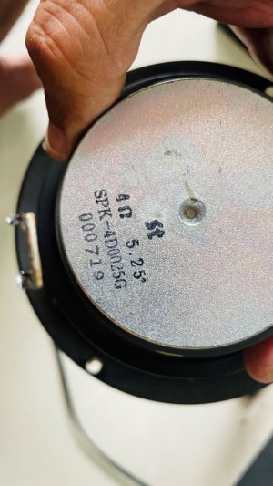

The product is almost 20 years old (but still works great), so I dont see its worth to contact Creative
Attached a picture of the original speaker. Don't think exact one (there is no model as well on it) will be available. The specs are 5.25 inch 4 ohm 22 w.
What's the harm in contacting creative, Just email. Maybe they are still using this type in another product. You will get some reference as to what alternate model u can use that is available easily. And yes you are right there is nothing available on internet by this model number SPK-4D0025G (from sale point of view).
If contacting creative does not fetch any result then you can take risk of buying similar type from a reliable vendor (online/offline).
Choice is entirely yours.
Just wanted to provide an update. I purchased the one I linked above and fitted. The brand on it is samcon.
It is almost perfect fit. Sounds pretty similar to old one. I can increase bass to full without distortion ( earlier one was producing distortion when increased to full).
