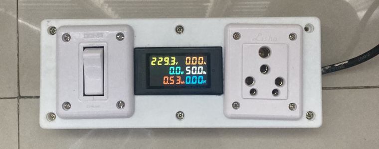

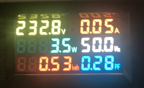

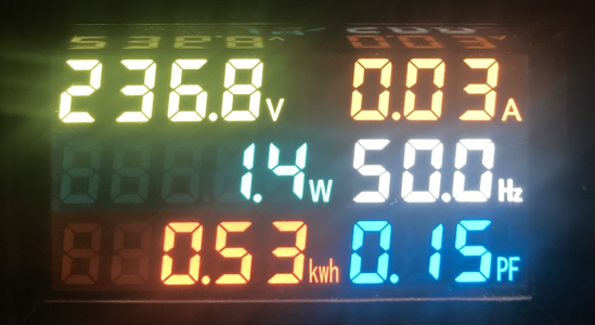

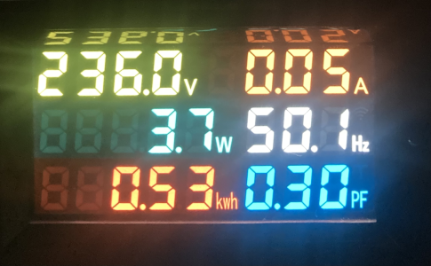

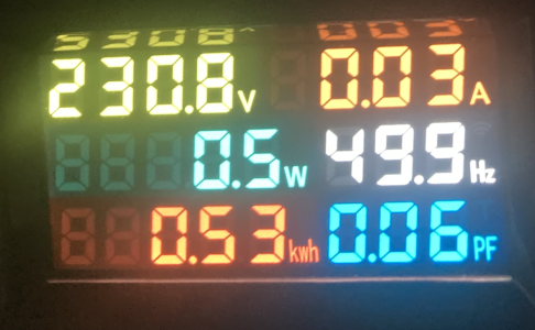

By sheer coincidence, I was working on a DIY project last weekend, using the AmiciSense energy meter to determine the power consumption of various devices in our household, and I never expected it would come in handy for measuring my music system's power draw. Here are some pictures I've taken of both the A07 and BT20A Pro, with the toggle switch turned off and on.
Aiyima A07 powered on, but the toggle switch is in the "off" position ~= 1.4W
Aiyima A07 powered on, toggle switch is in the "on" position but no songs being played ~= 3.7W
Fosi BT20A Pro powered on, but the toggle switch is in the "off" position ~= 0.5w
Fosi BT20A Pro powered on, toggle switch is in the "on" position but no songs being played ~= 3.5W
Interesting to note that there was no change in power consumption even after playing a song at medium volume.
Also, please take note of the change in the input voltage from when I was measuring the A07 to the BT20A Pro. I'm not entirely sure why there's a drop, but I can conduct a few more experiments to ensure an equal comparison of parameters.
Very low power factor. Ideally PF should be above 0.8. Low power factor indicates voltage and current out of phase. But i'm not an electrical engineer. Perhaps @Subbu68 can explain if this is OK.
