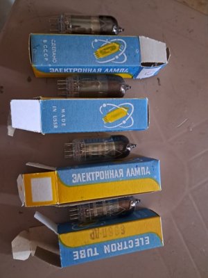

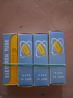

After discussing and exchanging ideas with my mentor, he suggested me to use a 6e6p tetrode connected as triode for the driver tube. As the 6e6p tetrode was a very inexpensive tube, i bought 4 of this tube - NOS for 22 usd including shipping which arrived yesterday. As i had already done a PSUD simulation of the schematic, it became very easy for me to migrate to this tube. I have now connected this 6e6p as my driver tube. I have used a more higher anode current for the driver (double than the previous tube) of around 9.2mA. This tube also has double the mu of the previous driver tube.
I am now listening to this modified setup since today morning and find them to be much better (atleast 15% to 20%) than the previous 6FQ7. I have not noticed too much difference with tube rolling from one brand to another brand of the same tube number. But chaning the tube number definitely has a solid impact as we now work with a much different bias current, amplification factor and topology of the tube.
This tube will definitely be for my keeps and looking at the cost of the tube, its the best mods that i have ever done for such a low price.
