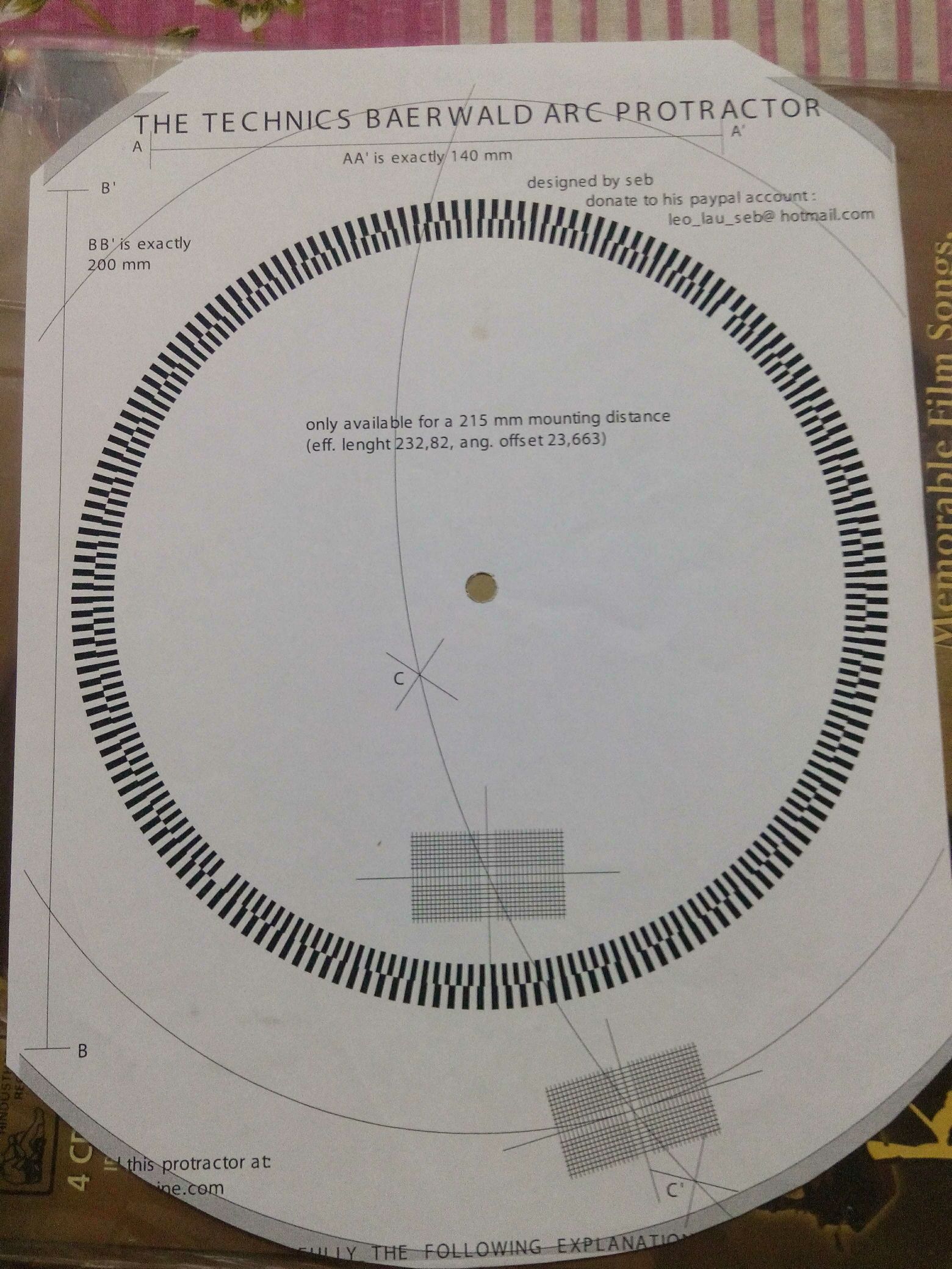

If your arm is an S arm, it is already angled for the correct offset angle. So align cartridge exactly along the length of the head shell and adjust overhang, and you should be done. If it's possible to adjust VTA, do that after overhang adjustment.
Overhang gauge, at 52mm from collet rubber gasket to tip is one way.
Or making alignment with baerwald or Stevenson protractor is another option.
Or simply print this arc protractor from vinyl engine site. It is best among all. Match arc plus two points. Done
I aligned my Ortofon OM pro S cartridge with my Technics SL-23 using this protractor. It took me not more than 10 minutes to do that and the results are amazing. Balanced sound in both channels, very neutral and plays till the last groove. Strangely the records also seem to have less scratchy noise than it used to be in the Dual 523.
http://www.enjoythemusic.com/protractori.pdf
You can take a print in a A4 paper and laminate with an transparent overhead projection sheet available with the stationary shop and you can align once in a year.
Agree with Joshua, Mishra and Hari. I printed out the baerwald protractor on a A4 sized paper sheet, suitably cut it out, similar to the one in the picture and glued it to an old and damaged LP, after aligning the center hole. That has been my reference kit since. Yes, the overhang gauge is the simple solution but if you want to fulfill your desire for precise settings, then the baerwald protractor is the way to go.
