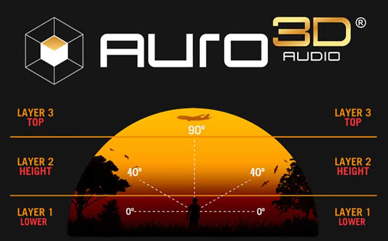

Did anyone installed Auro 3D setup and used Auromatic upmixer for airtel HD channels which has dolby content. How is the output? Is it worth buying AV receiver which is auro 3d compatible and doing auro3d setup ? Does Auro 3d upmixer works well with ott content and dish channels.

I am not qualified to answer your query by default, since I am not an Auro3D user. That said, per my theoretical understanding Auro is very finicky and completely incompatible with both Dolby and DTS not only in codecs, but with physical speaker placements also. Essentially this will render your HT setup dedicated to Auro; you cannot simply plug-and-play Dolby and DTS content in it anymore unless you go for some fairly complicated workarounds.

Yes, you need to place height speakers at a certain angle from MLP, but one good thing with this setup is that, Dolby and DTS supports this layout. On the contrary, Auro doesn't support Atmos Top speakers layout. Dolby just doesn't support Auro 3D's Center Height and VOG channels.

I wouldn't call it a gimmick, but if you are enjoying currently your 5.1 system, I would suggest you to continue using it. I would not recommend you to install 4 height speakers just for using an upmixer.
If you are going into 3D sound, minimum 4 height speakers are recommended. You can start with 2 height/top speakers, but my recommendation is to start directly with 4 speakers.
