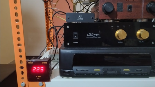

The fuse blowing thing is a normal thing. It is a good thing actually because it shows that your device is being protected. Just get few fuses of the same rating. Very normal because I see abnormal voltage levels in Pune. Extremely notorious in Bombay with adani supplying you voltage levels above ~250 v. I lost few things during the covid period and have implemented simple voltage stabilizers meant for air conditioners. Not lost a single device after having stabilizers for all critical equipments (audio/computer equipments), microwave, washing machine, dishwasher, fridge, etc). The only things not on stabilizers are led bulbs and led tube lights and ceiling fans and geysers). I lose led bulbs almost every two months or so, but I guess that's the price we pay where business tycoons have an extremely cozy relationships with politicians.
NOTE: I have voltmeters in all my rooms and I know voltages are always above 240 volts. The voltage below is after stabilization. Before covid the input volage itself used to be 230 volts.

I'm using 3 of these (available on Amazon for Rs 2240). This is for tv, subwoofer and amps. I also have my APC ups in front of another stabilizer. I use the UPS only for my raspberry PI devices and my HTPC.
Microtek EM 4160 Digital Display Wall Mounted Automatic Voltage Stabilizer upto 1.5 Ton AC Working Power 160V-285V with 3 Year Warranty
