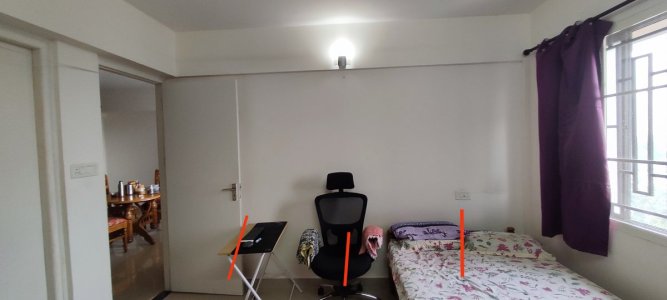

Definitely OWM3 seems to be my pick for now. How would these be angled when I sit close to the wall they will be mounted.
I think a photo of the area where you intend to mount these speakers will help so that one of us can chime in and advise best position

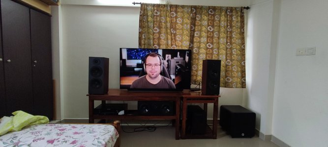

My bad. Attaching photos of the wall. Chair is facing centre and outeredge of desk n bluepillow facing LR. second photo taken from my seating position. IMG_20231108_094920.jpgIMG_20231108_095040.jpg

The OWM3 can be wall mounted on the rear wall, angle them 45 degrees so that it aims downwards to your listening spot. Ideal placement of speakers is anything between 5ft to 7ft from the ground. Dont put them too high else then you will feel you cant hear anything. Depending on your listening position, mount them accordingly.
