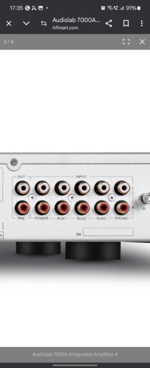

Who's saying anything about using it as a power amp? I said aux-1 in, not power amp in.
But even then will it work? Assuming you are going from the PC to the USB in of the Audiolab, then the USB in is your source for the Audiolab, you can not then channel the pre-out to one of the analogue inputs and select that as the source.
Hmmm. I see what you mean. You're correct. @v2kiran drop the idea, it won't work.

Ah I see :) …I saw that manual but wasn’t sure because the input said power.
thanks for confirming @jsmithe .
Yeah, it is a bit confusing since it says Power on the top of the amp. in the diagram and Input below.
It's still better than the 6000A manual that just says Power. Go figure. :-(
