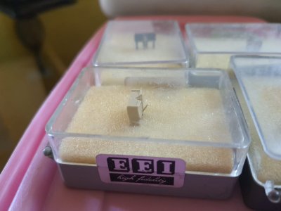

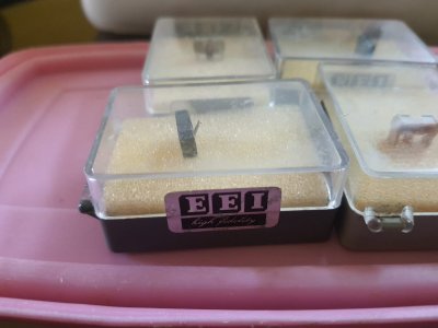

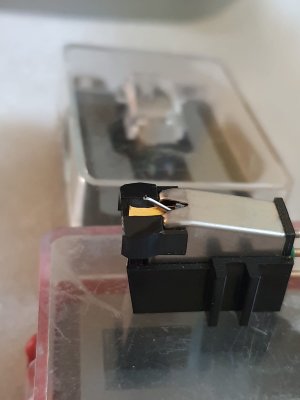

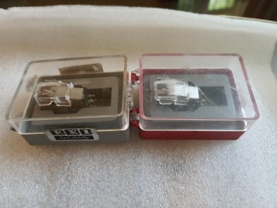

Do you have any photos of your sapphire tipped stylus? Nowadays some sellers are selling EEI stylus with logo of "EEI hi fidality", don't know whether it is original or China make. Can you give some comments about this?
Hi adk06. I do have the bent stylus and the tip is clearly sapphire like those found on old Philips sapphire styli. Unfortunately I have no system or knowledge of taking stylus close up photos. Sapphire styli look distinctly different from bonded diamond styli. If a close up of the stylus mentioned by you could be posted, then maybe me or our brothers here would be able to comment.
Encls pls find the classic 700 cartridge & stylus selling someone in the market. Pictures are appears to be new & recently manufactured which may be recon that it is maid by a third party possibly in China. Kindly share your views.

Well from the clear photo on the top right, it appears to be a new old stock EEI cart with a diamond tipped stylus ( further confirmation only on physical examination). The white stylus holder may be from a Shure cart. The transparent stylus protector cap is certainly EEI. I would recommend that u get these physically examined by some friend and also try to test them if possible.
New Old Stock items may or may not function as originally designed. The rubber suspension may harden or even crumble. The stylus tip bonding glue may not hold. So do check carefully.
You have a nice point regarding NOS styli particularly rubber suspension & stylus tip bonding. The very important parameter that every one forgets while choosing NOS products. Thanks for important info.
