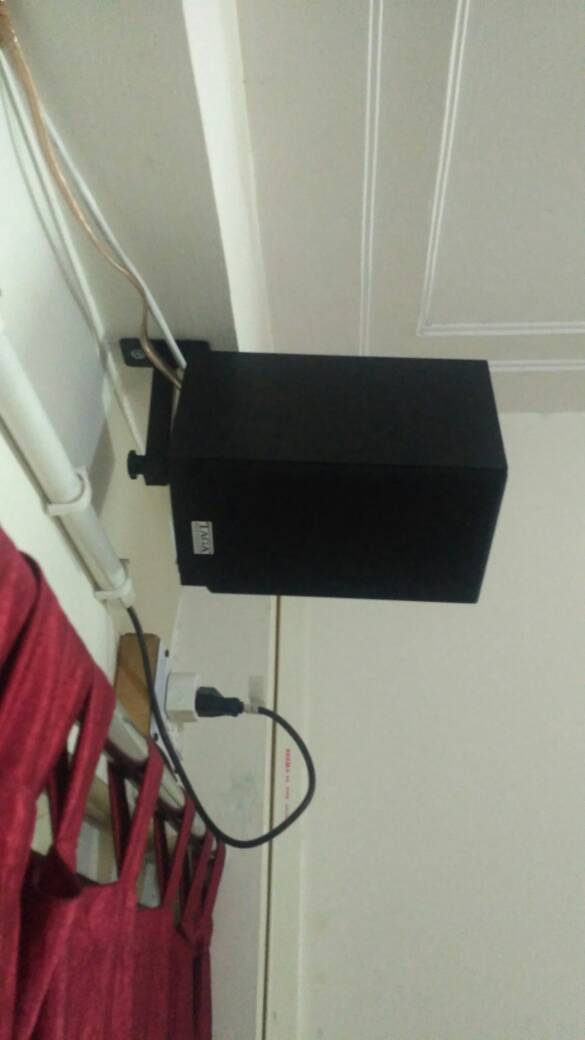

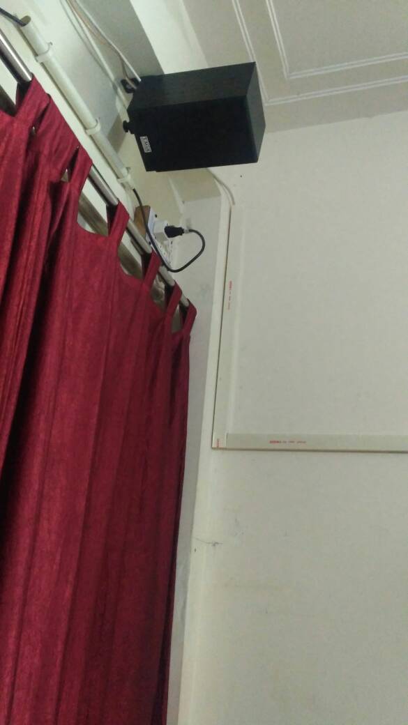

I attached a simple speaker mount (with a small square shaped platform for keeping a satellite speakers) to the base of the bookshelf speakers and mounted it on the wall like this--tilted position to the listening area, can make upward firing as well by just rotating the speakers up[emoji1] and it works pretty well!

are those mounts screwed to the bookshelves by any chance? the jamo s602 only have screw hole on the backside of the speakers for hanging the speakers to a screw, which mounts are those?
