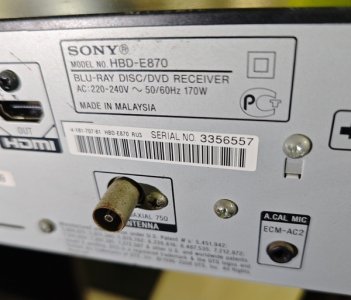

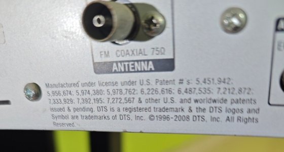

The wattage of BDP is all marketing gimic. Please check the rear of your BDP. It would show how much wattage it would consume. Total BDP wattage is 187 watts as an eBay image that I saw. The total wattage includes current needed for cd player, video processing as well sound amplification. So the speakers must be 20w (10w more likely) each. You can check and confirm total wattage as mentioned in rear panel of your player.

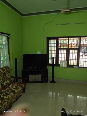

I think I should done this first. Can you post a few pics of the place with TV?
I am not fully understand what sort of pics is you want to take a look. Anyway, taken a couple of screenshots which are as under:
The ground floor living room where the TV/HT is kept. The room size is 13x14 ft with open entrance.
The TV kept on the left side corner of the room.
Rear side of the Receiver - it seems it has 170W power.

Thanks for the pics.. You have a room big enough for a proper 5.1 set up. I can foresee a challenge of placing center channel with the current stand.
Also, the 5 inch and 6 inch subs coming in zebronics/Mivi/LG/samsung soundbar/5.1 kits are NOT going to do justice to your space. Your space needs 10 inch SW at the very least
