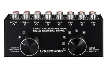

You can't use audio splitter. Splitters give you parallel connections. You use splitters to connect one source to multiple outputs. More devices you connect, the impedance keeps getting lowered.
What you need is a RCA switchbox. Many clueless audiophiles call it passive preamp (as if it is amplifying something). A RCA switchbox is a passive device. Some of these also have a volume control, but you don't need that.
Below are two example of RCA switcher / RCA switchbox. A RCA switcher is a total passive device. It doesn't alter the source or the output impedance. Such a switcher will not alter the quality of music.
However If you use a RCA switcher with a volume control, it will alter both the input and output impedance (again few clueless audiophiles call this too as passive preamp). Depending on how bad your current impdenance matching is, such preamps may make your music lively causing the person to exclaim that his preamp does magic. But the result can go downhill too. Ultimately one can spend fortune in acquiring and discarding such mislabled RCA switchers.
Now enough said about snake oil and pitfalls in choosing preamps. Below are 2 examples as promised
This gives you ability to select one out of 6 inputs and also gives you ability to connect to two different devices.
This gives you ability to select one out of 4 inputs and also gives you ability to connect to two different devices.

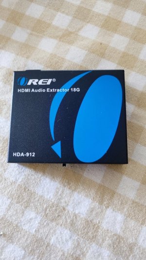

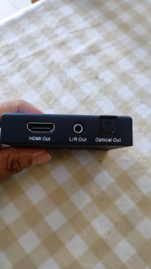

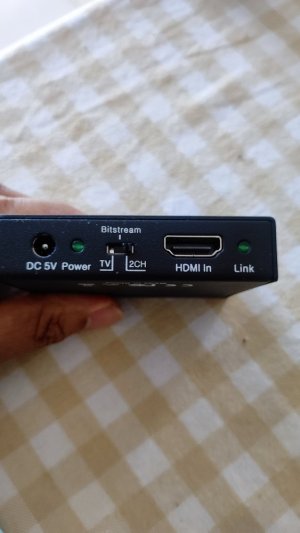

1000132345.jpg1000132344.jpg1000132343.jpgSo I ended purchasing this HDMI audio extractor which has 3.5mm aux and optical out - the only available inputs in my powered speakers. I recently acquired a used Bluray player which had hdmi out. Fed that into this device and used the optical out to connect to the speakers. This works perfectly as I intended. As for the cassette deck, I'll to have to look for one with an aux out or may have look for another solution to hook that up. Let me know what you think of the solution. Cheers.
View attachment 89159View attachment 89160View attachment 89161So I ended purchasing this HDMI audio extractor which has 3.5mm aux and optical out - the only available inputs in my powered speakers. I recently acquired a used Bluray player which had hdmi out. Fed that into this device and used the optical out to connect to the speakers. This works perfectly as I intended. As for the cassette deck, I'll to have to look for one with an aux out or may have look for another solution to hook that up. Let me know what you think of the solution. Cheers.
Have you checked the effect on final sound? I would like to have your opinion on any significant changes you might have noticed.
