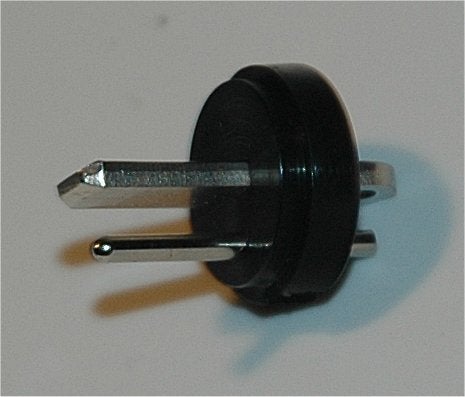

Those a Philips speaker sockets. You'll have to get yourself a pair of these to wire your current speakers to this amp.
These were quite common when Philips dominated the Indian market with Hi-Fi, in the 1970s and early 1980s. If you go to older electronics component shops and ask for Philips Speaker plugs, they may have stock.

Thanks, these are the ones that I should be looking for, on EBAY cost is 1.4k! Better to source locally, I'll try to get it. Any DIY possible as they look to be simple.

The Philips speaker plugs cost about 10 bucks each at local electronics stores in Trivandrum. I purchased a couple of these a few months ago, while restoring an old Holland Philips amplifier. Will run a check this weekend and pick up a couple for you, if they are still available. Will also look up by junk box, may have a few old spares, there.
There's Whole Lane in Hyderabad called as Gujarati Galli, Unfortunately nobody has it, They suggested me to go DIY for it, If you can source them locally it'd be great help for me. Otherwise can we add a regular speaker binding posts by opening a cabinet ? shouldn't that be possible ?

You can try the above, there is MX exclusive showroom in Gujarati lane.
