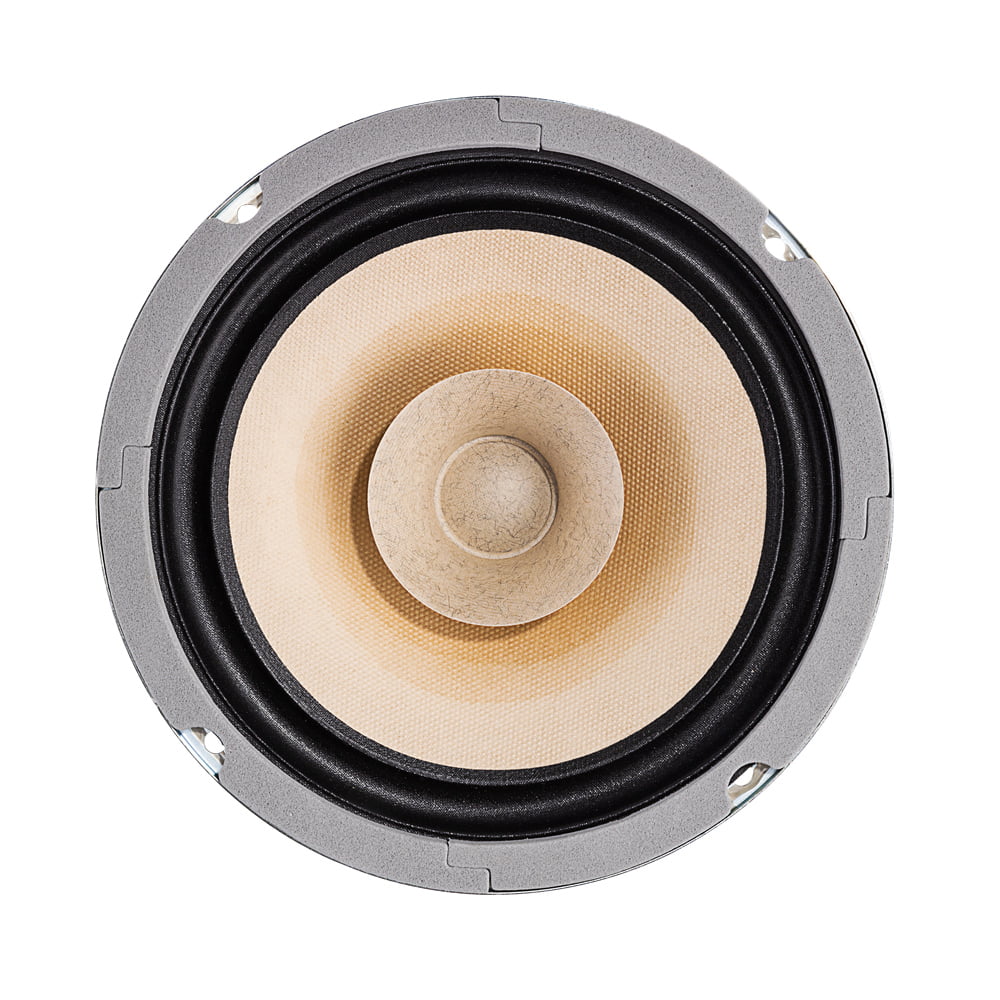

Before you make a decision , OB needs space and for bass you have to have drivers above 12 inch or multiple drivers . As yogiji suggests Faital is good for OB . Other options are hi q drivers you will get some in local market for 400 to 600 don't expect any high quality but it's a good starting driver to experience ob . You may have to eq them otherwise they may sound harsh . There is a brand called award which has a 3 inch driver which cost 200 and the sound good in OB considering the price .

Yes i did. 6"
May be you try some vintage oval isphone drivers in ebay and it will sound damn good in smaller OB combined with 6" woofer with 2" tweeter.. It may not look not so big and it can accommodate like a desktop speaker. The sound is so realistic.

F6 was an inexpensive driver built for car use. I loved its specs and cone and had completely different ideas. Got gifted a pair and immediately placed them in Open Baffle and played through Tube 45 SE. Shared my observations with all. Even measured TSP which were way different than listed and were just fit for OB.
The creator of F6 and owner of Lii Audio was baffled at my findings. Saw a big opportunity And then started creating his whole OB specific drivers.
And now it’s on their website that F6 is NOT just a car driver. It’s still the best VFM FR for OB despite its poor chassis.
