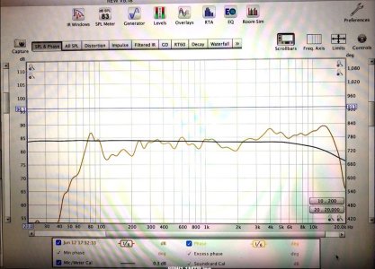

8PW1, Measured on open baffle at my seated position as a single driver, driven by 6L6 SE amps:
These two are just examples to give an idea as what some select fullrange drivers are capable of. However measuring TSP of the actual drivers tells one what enclosure each would be well suited for. IME putting them just for OB duty is otherwise wasting a great driver. Depending on their TSP, they could really shine in a BLH or FLH or Ported or even as horn loaded OB or just a horn design. And yes, since these are mostly high dB, 95 plus, these really bring out an amazing listening experience when driven from SET or a DHT.

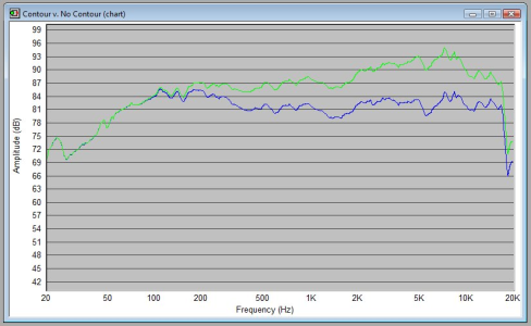

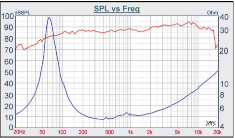

Take a look at the frequency/impedance chart below of a FR driver. Most would consider this a decent FR.
But opinion about this from a guy who knows his stuff is:
...the driver sounds screechy, shouty, honky, and virtually unlistenable without a great deal of reinforcement from cabinet resonance, or maybe reflected midbass output from a front-firing vent....

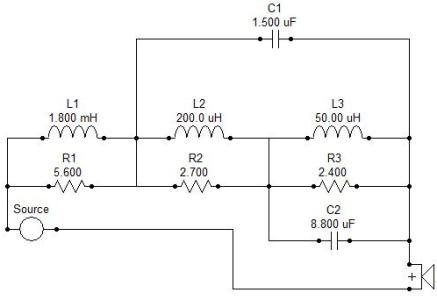

So, he developed a "contour filter" to fix this:
*GREEN: without filter
*BLUE: with filter
And here's the filter:
