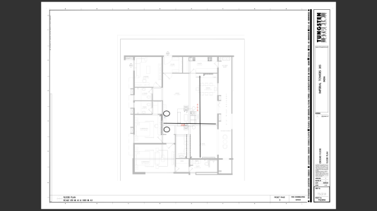

coming to the room size its big and I have different listening locations and it can lead to complexities. I am attaching the room drawing. the room is 25 * 40. And black circles in the drawing represent the speaker location. when they're a lot of guests and do entertain a lot of guests at times. I want it to be adaptable to such requirements and I ideally I want the music to be present all along. I am not sure it can't be achieved with 2.1 set up. I have a budget around 5-6 lacs. 3 for speakers, 2 for amp and 1 for sub.
regarding neighbours I need to worry about my below and above residents in the apartment. no issues with the music passing through walls.
and I plan on using Mass Loaded Vinyl for flooring and ceiling. flooring I need to confirm with vendor not sure if it is effective under seat concrete.
please have look at the attached room dimensions.

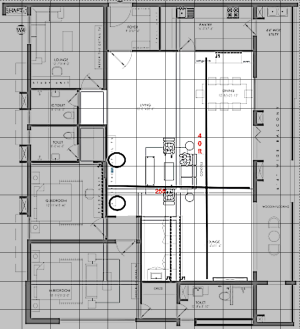

Thanks, Raj. Okay, this is what I think I'm seeing (grid about 5 ft/div). Is this close (and do you know ceiling height)?
If you do nab that old manual, skim Ch 5-7.

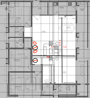

yes the grid is spot on. I changed the speaker position I positioned it wrongly in my first drawing.
please refer to the the new red circles for speaker position and ignore the ones in black.
also I want to achieve two listening positions L1 and L2. L1 at around 11 feet from speaker and L2 at 18 feet.
is it possible to achieve the same by changing the angels as and when required?
I found the manual will go through it and get back with improved knowledge.
thanks for your time. please find the attached picture.

would you want to consider an active wireless speaker like KEF with 2 subs ?
This will be far more simpler and since it will eliminate cables you might be able to place the speakers 90deg from their current position ie their backs towards the longer part of the room hence removing any bass issues. the speakers . You avoid any cables other than the power cables ?
I am assuming you are streaming hence you can add any streaming device to the same.
You could plan to sit perhaps 1-2 m from the wall and the speakers 3-4 m from you .....My guess is it will be afar more simpler system
most important is that you like the sound signature of the KEF...

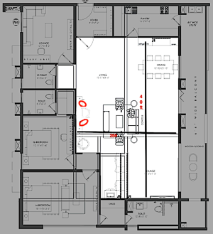

You need not work the manual (unless it's fun, of course). Suggested it because the space is large and to readjust perspective to that of sound-reinforcement, if only temporarily. This is the last perspective most "audio people" apply. It's a perturbation for your head as you consider what you want for uniformity of levels in "normal" or "entertainment" functions--and one that doesn't include the room as an afterthought to be treated later. You can go in any direction you choose. It's a large space. My intent is to foster consideration of what you want to hear when you are in various locations. The current incarnation is much like a central array and, at the opposite corners, will sound more like "speakers over there" vs. more uniformly distributed sound even at low levels. Either is fine, the idea is to avoid surprises.

Got it..the advantage of wireless is that it can get the best benefit of placement in your room. a combination of the LS50 +pair of their KC62 subs will easily substitute the LS60. and since its all in one no more cables other than a power cord and a subwoofer connection is needed . having no speaker cables/interconnects in a room is a blessing.
The reason i suggested it is that your current placement has one speaker near a corner and the other near the wall both of which will mess up the sound for the speakers you are looking in your budget
Is it an option to place the speakers near the shorter wall instead of along the longer ? you can place them 2 m from rear wall wti the usual 6-8 feet between them.
The naim unity is a wonderful all in one. Another great speaker which can go with it would be the Fyne Audio 502 or if you can stretch a 501 and you will have a very good combo and since you will not need a sub with this speaker in this placement . I prefer Fynes to most speakers
