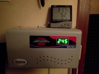

What is the voltage rating written on the back of your avr. e.g. My Yamaha avr is rated 110v - 240 volts. Going to 265 volts is way beyond the max tolerance. This is the current voltage in Pune. In my society many many people have lost tv sets, microwave oven, RO watter purifier, laptop chargers (including macbook chargers) after the lockdown period when the mains voltage has been increased from 230v to 240v. Do yourself a favour. Get some kind of stabilizer or voltage cutout switch and protect your equipments. There are quite a few threads on hifivision on this topic.
BTW @SriniN I see that you are from Pune. The problem I have highlighted is from Pune. My society even complained to MSEB. But the MSEB insist that 240v +- 10% is normal and if equipments blow then it is the equpment fault.
This is the current input voltage

@mbhangui ...thanks for your detailed explanation. I just caught up with these messages. Very insightful. Thankfully we didn't have any other incident like this with the other gadgets, am sorry to know that you and your neighbours had such issues with so many gadgets at home. I'll surely get a voltage stabiliser asap. Thanks again
