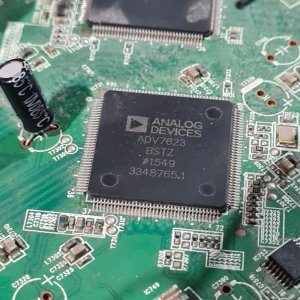

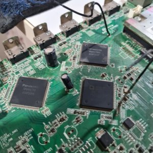

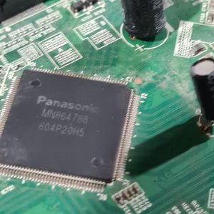

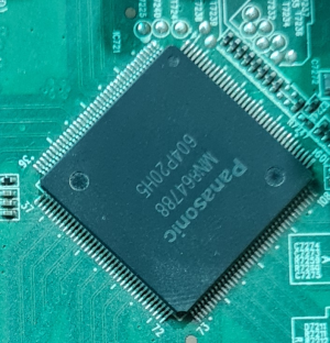

Hello Friends,
I have been using this Denon AVR-X1200w since long. I cant upgrade due to Amplifier Dimensons.
Problem I am facing is NO output from HDMI. I am an electronics technician myself and found that HDMI Chips getting heated.
1. PANASONIC MN864788
2. Panasonic Mn864788A
2. ANALOG DEVICES ADV7623BSTZ
Can you advice the following.
Can I get a HDMI card to buy ?
or should I replace the chips and test it ?> 20241002_182357.jpg2024-09-23 18_45_38-20240923_141529.jpg  -  FastStone Image Viewer 7.6.png20241002_182406.jpg20241002_182401.jpg

The electrolytic capacitor looks gone in the above two photos. But i'm not sure because the photo of the capacitor is not clear. Is the top part bulging outwards? An electrolytic cap will have the top part flat.
How do you know the HDMI chips are running hot?
Also, if the unit worked fine for over 10 years (1200w is a 11 year old model), then it can't be heat else it would have failed a long time ago.
I don't know how you are going to de-solder and resolder those chips without a factory smd based solder machine. Those are very fine circuit contacts. Easier to replace the circuit board itself if you are 100% certain it is the chips that have failed.

Hello. Here is an update. We were able to get chips replaced. We also got video output. But only after the unit heats. Any solution ? I am thinking to replace a few electrolytic capacitors. Please advice.
