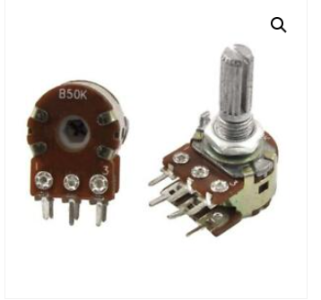

The volume control that you see with a single knob is actually two separate volume controls rotated by a single knob. For stereo you require two separate volume controls, one for left channel and one for right channel. One is closer to the behind and the other is closer to the front where the rotating knob comes out. The probability of both going bad at exactly the same time is rare. Also the one behind is always more exposed to elements and starts giving scratching noise first.
e.g. is this (a cheap one) The costlier one will be inside a housing, but basically all of them are more or less the same. So actually you have two volume controls and one of them has carbon particle that has loosend a bit.
The brown bakelite thing has carbon coating on which a slider moves. Few of the carbon particles become loose and cause noise. The carbon strip can be cleaned using a spray.
Here is a youtube video showing the gory innards of a volume control
