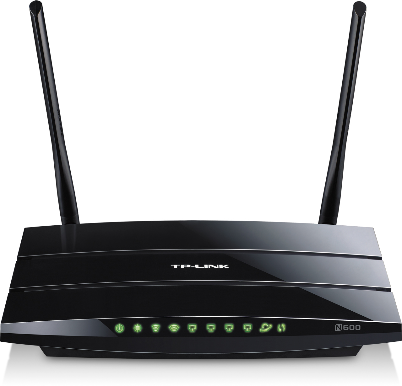

I bought this n600 baby (TP-link wdr3600) last week for 4700 from flipkart. It's an Atheros Chipset, no Ra-link nonsense.
TP-LINK TL-WDR3600 N600 Wireless Dual Band Gigabit Router - TP-LINK: Flipkart.com
It's the best router for its price range and performs 15-35% better than its immediate higher model. Get this one without doubt, I did a lot of research for purchasing a good router in Indian market. Using it in 2300 sq ft flat, 3-5 bars signal everywhere. No drops. Dont bother putting on the 5ghz unless you have more than 5 networks with 50% + signal within range.
So far the performance is stable and I can stream hd movies wirelessly from hard drivers connected via usb to router. You can connect more than 1 hard drive onto 1 usb port by using powered usb hub. Supports print server, ftp, media streaming to phones.

I have the same router as corElement (WDR3600) and can vouch for it. Note that it is a high end router with around 128 MB RAM compared to cheaper routers which come with 16/32 MB RAM. All that extra memory helps if you intend to use the router as your download client/NAS as well. If you are comfortable with linux, you can install openwrt on it and extend its capbilities beyond factory firmware.
