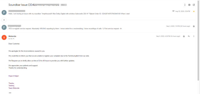

Yes its new, I was just 1 day late before I could raise replacement request! I did not use product extensively enough during initial phase. It all sounded fine.
I raised warranty claim but no support from brand yet, their 3rd party provider Jeeves are closing requests by reporting wrong updates like resolved, customer not responding, customer re-scheduling blah blah.
I have to keep raising new requests... and now here is another delay tactic - their system encountered some technical glitch!
I'll persist and push them, until I lose my patience and go with legal route.
