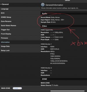

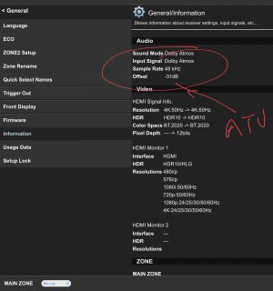

so tested on ps5 atv and tv app.. SQ remained the same (Atmos track)
So I got a xbox series s today in the name of science 😆
Will test tomorrow and see what it yields
I don’t think I have it figured out yet.
There was a very noticeable level difference between the two sources even though both were set to passthrough audio (xbx was louder for the same volume level on AVR)
When i checked under AVR settings> Information, I see the ATV is applying a level offset of 31db (reduction) while xbox isn’t for the same content (Altered carbon s01e01- Netflix) (see screenshots)
Not sure if its the dolby encoded level offset . Posting it here for pointers (and also for others to check) and will also raise a thread on ASR
