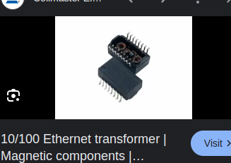

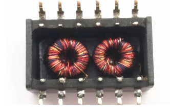

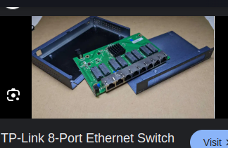

Extremely valid and well said. The thing about buffer is what people forget. If you are using Linux with mpd one can choose the buffer size. Only when I keep the buffer very low does the dac gets affected (especially when I play DSD). Then there are practices that cause more problems than solving it. A good example is using expensive switches and expensive ethernet cables (e.g. audioquest). It is a grave mistake connecting a shieled ethernet cable to your audio chain when using a streamer. The shielded cables introduce noise from the noisy smps powering the ethernet switches into your audio chain. You use such an ethernet cable then the only solution is to get an expensive switch with LPS, etheregen and what not to eliminate the noise. Just like the buffer used when using USB, the ethernet switch is galvanically isolated using transformers. each port of the ethernet switch goes to a transformer shown below. It makes no sense screwing it up by using shielded ethernet cables. I use normal cat5 cables for connecting my streamers to the switch.
