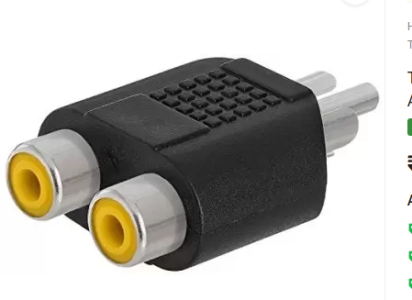

If you are using analog input to the AVR then you can put a RCA splitter like this to have the source go to the avr as well as the new amp that you will be putting.
