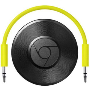

Do check if using a Chromecast audio (available cheap) will solve the issue. Knowledgeabls FMs, please advise. Read the first user review in this page:
Chromecast audio is no longer manufactured. Used ones do pop on the forum and disappear in a blink
