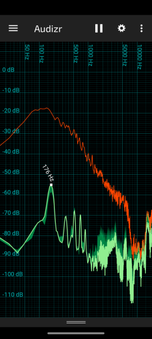

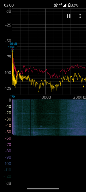

Not a 50 Hz hum either. More like 170ish.

@k-pad ..usually ground loops cause audible hum through the drivers itself. And DC on mains will cause internal hum from transformers. This is mostly 80% of the times. I find the current situation peculiar, in that we are having a transformer hum coming through a RCA cable, which is usually caused by DC. If the above change of power plugs doesnt help, I would suspect some issue with the internal amp and will probably need a thorough checkup by a qualified techie.
Thinking further, the last possibility is the subwoofer RCA cable picking up something, probably due to close proximity with another power cord.
