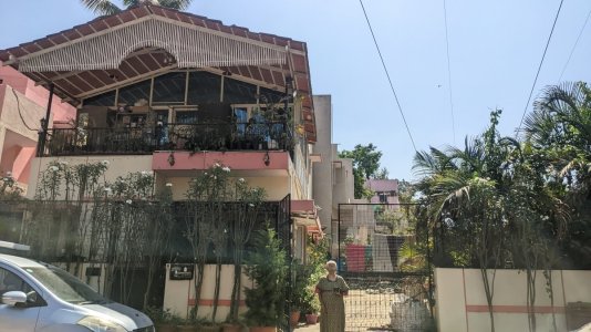

As per Karnataka Power Transmission Company - there has to be a 12 feet horizontal distance between my structure and the wire. So my discom told my transmission company to do a measurement to confirm., reason being many folks have died recently going near the wire - like flying kites or trying to harvest coconuts...etc. and the police call the transmission folks although its the fault of the house owners as house owners have constructed below the wire. Like in my case, the transmission cable has been laid more than 60 years back and is 220V.
Although in our house we have left 1000 sft of our 2000 sft plot due the cable running over it...there is one spot where the wire directly goes above a temporary steel beam, glass and mangalore tile structure I constructed which acts has my HT room.
So my discom is still waiting for the transmission company report - so there is a possibility structure may be 1-2 feet less than the recommended distance. I am waiting for the report to be made public so that I can reduce the height.
Either which way the discom folks give power to illegal and unauthorized constructions...Just doing some drama in my case since I had spoken to their GM and Chief Engineer..etc. Tomorrow will speak to them again.
