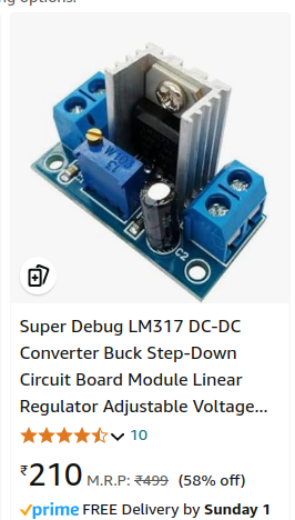

You can use around 6-8 NiMH batteries in series behind a low noise LPS like LM317 regulator. It is just Rs 210 or so. Replace the capacitor with a better one from Keltron, adjust the trimmer to give you 5.2 v and you will be done.

For nimh I don't need to do all this as 4 of eneloop batteries are able to power the allo usb signature and works fine but they discharge so quickly in around half an hour. So for nimh dont need the voltage regulation but high capacity nimh batteries are not available to could power on for atleast 4-5 hours.
One option is to have multiple 4cell packs of eneloops (let's says total 40 batteries) and putting them in parallel to each other but it would be a hassle to charge them all and beyond my diy skills to make a charger for it.
The options you offered would be useful for lifepo4 and li ion and other batteries where voltage is above 5v and need to be regulated. But then these batteries are not as charge friendly as nimh (that's why you will always find them coming with bms) and i dont want to make a blast in my room. But mind you any regulator in front of battery will cause noise (only that it would be isolated) but not keen to go that route if i want to just operate on battery.

Yes. Putting in parallel will allow you to run it longer.
Putting 6-8 batteries in series behind a low noise regulator will also allow you to run longer
So you have two methods. One is to put multiple 4 packs in parallel. The other is to put more than 6 batteries in series behind a LPS. The first method requires zero diy skills. The second requires DIY skills.
