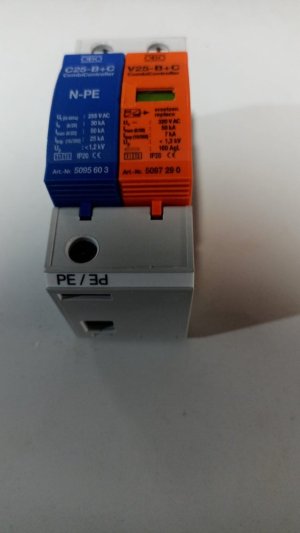

Install a 3phase surge protector in your mains. It’s very effective. Attached is for reference of a single phase surge protector. The green display will change to red when it needs replacement. You can google SPD and its types to get more information
