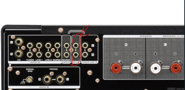

Model 30 is beauty on the other hand will match with my already SR7015 AVR setup has vintage feel which i love with dedicated Control Knobs for Bass and Treble but on the other hand it does not have dedicated Sub out it has two preout i am not sure if two preout means i can use both of my SUB?

The only thing where i am confused is Model 30 has Two Preouts as you can see in the attached images so one preout can be used for one sub? i am not sure how it works in Stereo AMP

Marantz Model 30 has only one "set" of preouts, left and right channel to connect and outboard power amp, 1 sub or 2 subs.

Also, the model 30 does not seem to have subwoofer out.
