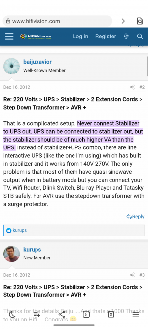

Pasting the comment from stackexchange.com
//Make sure to buy a good stabilizer with twice the wattage of your inverter. A 2 KVA Godrej or Vguard stabilizer would do fine.
I have been using 3 inverters with this arrangement for 10+ years with no issues. But never connect a stabilizer to the output of your inverter as this may damage your inverter.//
Again, I'm not gonna tell this is THE solution, but since I'm in a position to test out all possible scenarios, I'm gonna try this one once i get the AVR (of course after cross checking with the Denon technician).
