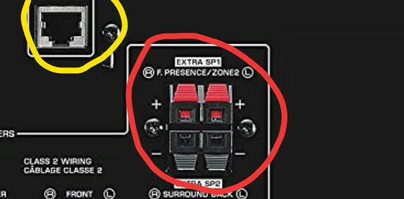

And what are these ports for?
https://image.prntscr.com/image/0jFONZS9QM2mr9saTkPlRQ.png
And this cable do we need for sub woofer? https://www.amazon.com/Mediabridge-ULTRA-Subwoofer-Cable-Feet/dp/B003FVYXY0/

Those red color marked port in attached image for connecting speakers according to speaker configuration.If you use 2nd zone options this will act as speaker connector for 2nd Zone output.if not we can configure as Front presence speaker again it is based on ur basic speaker configuration.
It will be mentioned in manual clearly.
Image attached shows rough idea about front and rear presence speaker configuration.
Based on your model the capability differs example :-7.2 or 9.2
Yellow color marked port obviously you might b knowing it is RJ45 network port
Thanks buddy, yes I know about the network port.
Confused about extra SP1 etc. It's now clear.
