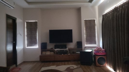

This is what I hav in mind. Enclosing a pic of all curtains closed. Pic is lil brighter than reality. if i prepare to project directly on the sunken wall, I wd get 95" only. With some wood levelling work by levelling sunk n adding the side walls, wd get 110" on ply wall. Cheaper options I have in mind

This room is too bright for a projector. It would be a waste of money. Either completely black it out or get a big TV.
I agree with this. This is most likely because of the white (ish) paint. The light bleed from the right side is the main culprit.
However, if you are willing, you may go for oversized curtains on the right window after repositioning the curtain rod a little higher than its current position. The objective is to increase the overlap with the wall area above the glass and also make the curtains touch the floor to minimise light bleed. There will still be some bleed from the top but it will be significantly less compared to the current situation.
For the screen, you may want to go with a pull down / motorized one which can cover the front windows too. Not sure how wide that is, but with the curtains and the screen's own backing layer, light from the front windows will get significantly reduced.
In case you are going for a motorized or a pull down screen, there is probably no need to fill up the sunken wall with ply. You can mount the screen frame on the two raised edges (above the front windows). These type of screens are typically hung from the extreme edges only with no support in between. The frames are made of aluminium so they are quite sturdy and do not require additional support in the middle. This will also allow you to switch between the TV and the projector on demand. The screen will roll down in front of the TV when needed.

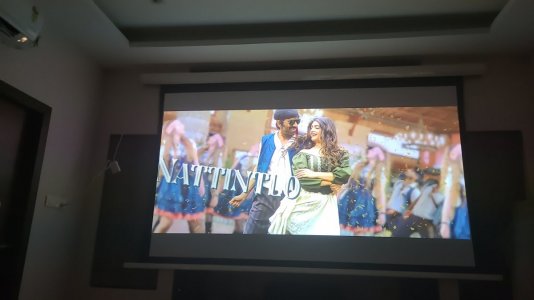

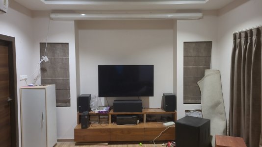

Finally bought and installed Elcor Pro tab tensioned motorised screen of 120". Overall experience is very good. Can't complain on the quality of the image for the price I paid for projector and screen. Enclosing a few pics.
Projector image quality is good in semi ambient light as well.
