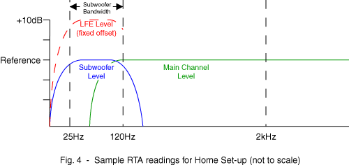

Does encoded LFE actually get distributed to mains, if "no sub" option is chosen?
I know that sub can be set to "LFE + Mains", but vice versa is where the doubt lies.
Raghu
When no sub option is selected the front speakers is changed to large. It cannot be set to small so yes the LFE signal is sent to LR
