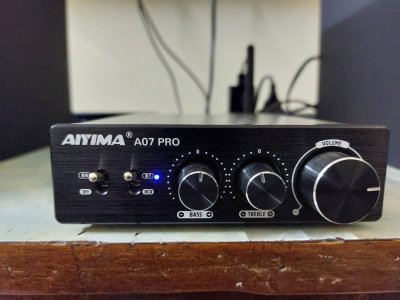

Yes trying the same, the problem with tone controls is that - they are responding with bigger changes for very tiny change! I was aware of this when I read Audio Science Review before buying. With Mission LX-2 MKII speakers I am experiencing the same - controls are definitely sensitive.
After reducing trebles, it noticeably sounded a bit warm but the bass lost some tightness & instruments became quieter(not a lot but noticeable).
I need to keep playing with the tone controls - I'll update later here how it goes.
Update: Look how small adjustments I made, made quite noticeable difference in output! Will continue testing further. I am pleased with these settings!

^I meant amp chip. I've been testing with the tone controls I posted photo of in the post #7 & it's better now.
Some warmth have been added, it took away bass resonance of certain bass frequencies, trebles isn't that sharp anymore, vocals aren't thin sounding as before. Overall it sounds flatter/smoother - I am pleased now.
