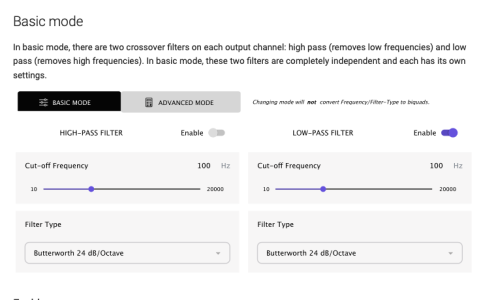

Please share your experiences and recommend miniDSP HIGH-PASS and LOW-PASS settings for open baffle speakers.

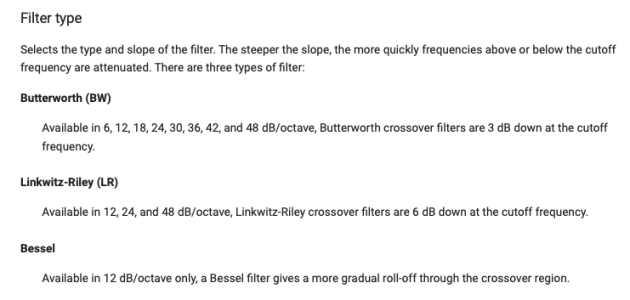

And also please recommend Filter Type settings for open baffle speakers.
