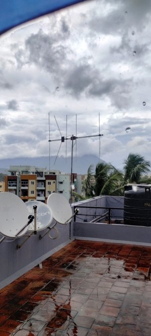

When you speak of using an external antenna for FM, the paramount factor of consideration is the reason why you want it. If you are residing in an area where the FM stations are local and signal strength is high, maybe you are just looking for an antenna for your tuner (assuming you are using a component tuner without an inbuilt antenna). In such case, you would need a simple telescopic antenna without an inbuilt amplifier. You can pick one of these up from your local electronics store. If you live in an area where there are reception issues, an outdoor yagi antenna is the best option. Personally i am not a great fan of antennae (especially indoor ones) with in-built amplifiers. In my opinion one should use an amplifier (called booster in India) for both indoor and outdoor use, only when the signal strength is too low. This is as amplifiers cause issues with feeder imbalance, noise and overload. If you want to construct a good outdoor antenna for receiving distant FM stations, FM Omishra's design is the best.
Edit: yagi antennae are directional and hence you may have to follow orientation protocols

Thanks for your reply. Mine is Marantz ST4000 Tuner sourced hogback from another FM. The The antennas were not there. I have connected the FM coaxial input with 2 Ft length of an old CRT TV coaxial signal cable. It is working fine but getting signal bars 40-50%. Thought with dedicated antenna I may get full signals. I will explore the DIY way as suggested.
I personally recommend an outdoor antenna for FM radio. DIY is a option or you can get one online which is readily available. I made a folded dipole antenna and it works well and I am able to catch stations that can't be listened using the built in telescopic antenna.

Attaching the picture of my DIY antenna. I made is using a 1/4" copper tube used in refrigerators. I used the calculations from https://www.changpuak.ch/electronics/Dipole_folded.php.
@zero7 Nice build.
