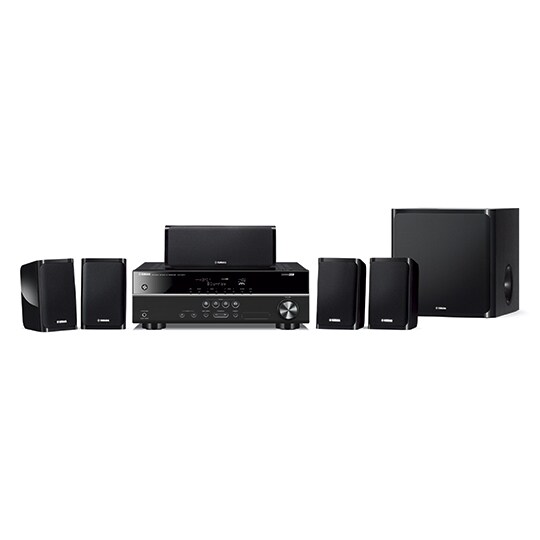

I had a Yamaha 1840 model & paired it with BIC America PL200-ii using the sub out option. The results with BIC America PL200-ii are awesome.. but since I had a older model that is Yamaha 1840, There no different setting for 2nd SUB. I only have 1 setting for crossover & that gets applied to both the subs.

If you refer to the Yamaha 1840 specs.....it has a connection for hooking up a passive sub (which is part of the standard set) and also a sub out port.
Please note that this is a work around being suggested and not recommended. Since the Yamaha 1840 is a basic entry level AVR, you cant do much with it. (Unless you update the AVR). Ideal scenario is to use either the Sub Out Port or hook up a passive subwoofer......
Now if you have TWO BIC America PL 200 subs then you may need to connect one sub using the Sub Out port and the other one using the HIGH LEVEL Speaker connection..(refer to manual....High Level speaker connection is meant for Stereo amps where there is no sub out port).
The setting of 160hz is in play as the Original Yamaha speaker set is satellite speakers. Ideal scenario is to keep LFE at 100hz or 80hz for the sub out port section. (Crossover setting on the subwoofer for this sub should be OUT...which means the Crossover knob on sub will not function)!
