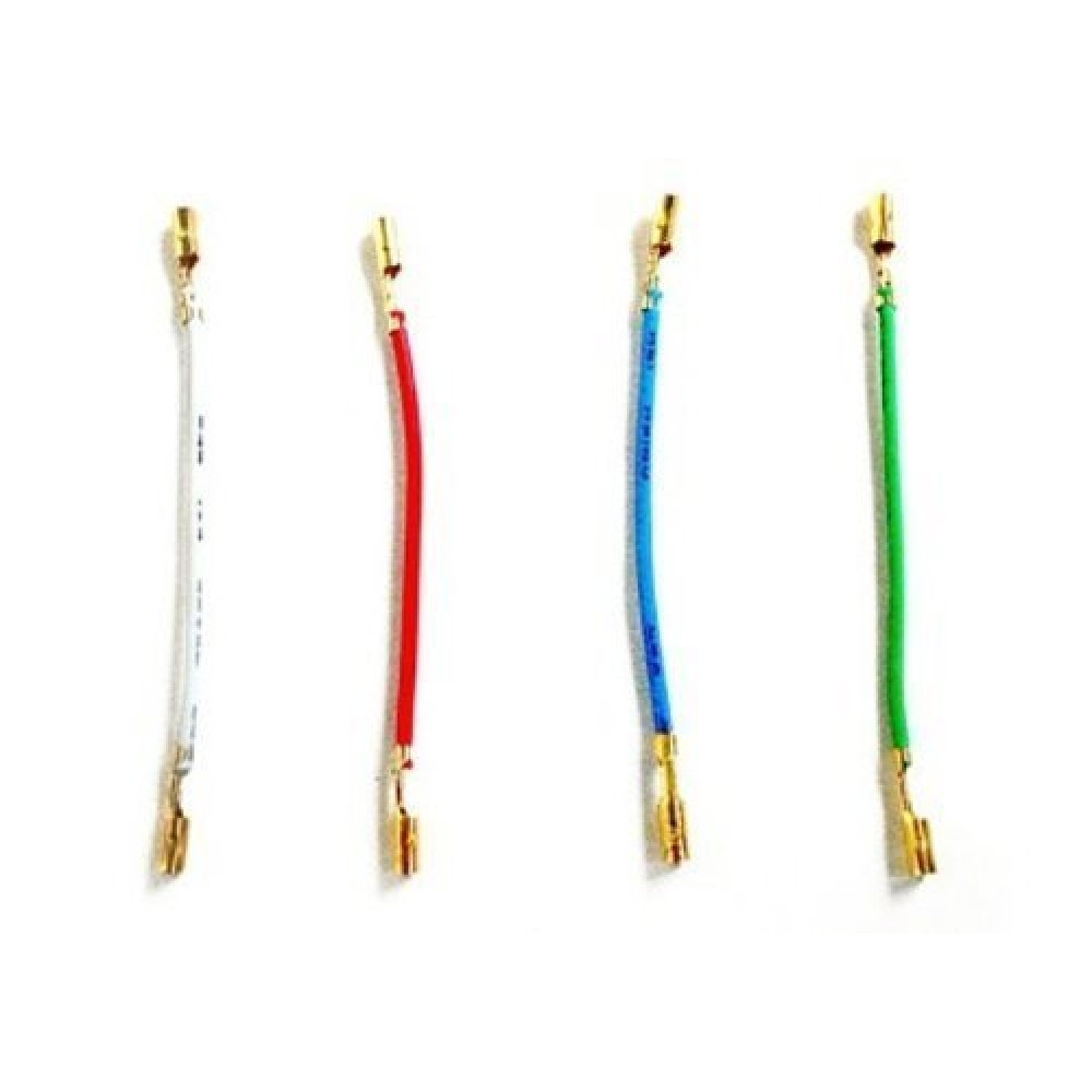

this is what you required in the first place, a new set :
