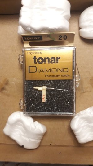

I found one stylus, not what I had in mind. I had purchased one from UK and had kept it with the old stylus because in almost all of them, 78 was unused. But I found this from 2017 Nov purchase from Holland. The dutch may have believed this one to fit GP204. I have requested Reubensm to advise on the stylis I have right now. A picture is attached.

Hi UcSam. 1.The stylus pictured is indeed for the GC O32, fitted with the Gp224 or 204 ceramic cart.
2. The GC 032 motor is suspended by three rubber grommets whish must be at the height where it is approximately in the centre of 45 rpm gradation on the motor step pulley. These are available on Amazon. I had fabricated with cardboard. Bit noisy.
3. The stylus above is for AT3600L. It will not fit on the EG1400.

I think I have a mixed bag of Saphire and Diamond tips. This one is Diamod and the oone from UK was Saphire. As I remember now, I wanted Diamond tip, hence this one.
