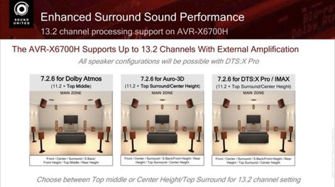

Hi All,
Planning for an upgrade, from 5.4.2 to 7.4.6 set-up in my living room..
Room dimensions : 14ft (W) x 11ft (L), 150 Sqft room..
Screen : DIY 100 inch Acoustic Transparent screen, 16:9 Aspect ratio ..
Projector : Xgimi H1, 1080p (DLP-LED projector)..
Current AVR : Denon x 3300
Speakers : Taga Harmony Platinum series..
Subwoofer : Quad DIY sealed passive subs, powered externally..
Power amps : 12 Channels (8 Channel Sonodyne Power amp + 4 Channel power amp) has both RCA & XLR inputs..
Acoustics : 100 cuft of Uncompressed rock wool spread evenly on the ceiling, approx 40 Sqft of acoustic foams on front wall (besides the DIY screen)..
Tentative upgrade : Denon x 6700 / Marantz 8015 / Marantz AV 7706 (to be announced) / 13.2 capable processor from any other popular AVR brand..
Denon x 6700 and Marantz SR 8015 both have support for front wide speakers and have 13.2 pre-outs.. I believe the upcoming processor from Marantz (AV7706) too would be 13.2 capable..
The DTS X Pro support on the above models makes an interesting, possible speaker layout in my room..

- Support for front wides (I can't do a surr back in the room as i sit against the back wall, but can accommodate front wides, and native support from both Dolby Atmos and Dts X formats)..
- Provision for 6 height speakers and an interesting speaker layout for Dts X..
Dts X Pro seems a look alike of Auro 3D speaker layout from the above image..
How much of a difference would it be between a premium AVR like Denon x 6700, Marantz SR 8015 Vs a standalone multichannel processor (Marantz AV7705, 6) ?..
Looks like a overkill for small sized room.
There are members who have done 9.1.6 in a 12 x 12 room on AVS forum.. Am planning to do 2 speakers less than them, in almost the same or slightly bigger room size:) ..
