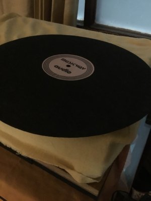

This is a 2mm anti static felt felt mat which is a definite upgrade over the stock Rega mat. Do check on the net. I am trying to locate my 2mm acrylic transparent mat which was stored inside an LP cover, and my memory slips. Let me trace that out. As recalled this should not be more than ₹2200.
Thanks for the info.
Shall check out MusicWay mats.
If you remember which sleeve you stored your acrylic mat, please let me know what's the brand, shall check it out too!
